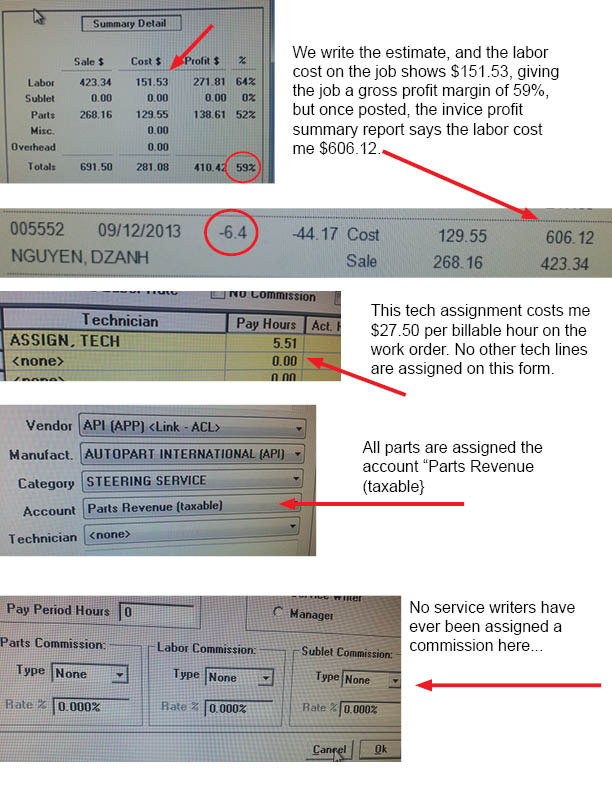

We're having an issue that Mitchell's support team just can't seem to figure out, and we need some advice.
The "Invoice Profit Summary" report is incorrectly reporting appropriated labor on multiple jobs each week, with no identifiable pattern or cause. For example, if there is one labor hour on a job, that line correctly reflects 1 hour charged to our customer, one hour assigned to a specific technician, and the gross profit on the job (Check Profit) indicates the correct number of dollars in labor cost associated with that, reflecting the profit on the job correctly.
However, when that job is invoiced out, and the "Invoice Profit Summary" report is run, the labor assigned to the job is exactly 4 times the correct amount, causing the reported profit on that job to plummet, affecting the weekly totals in that report also. Keep in mind, it is a seemingly random occurrence, showing up on different technicians, different types of work, etc.
I unposted one of these anomalies, removed all the parts from the order & reposted it. The invoice profit summary report then reported the labor cost correctly. Unposted it again, re-added the parts on the job, and the labor cost quadrupled again. (??) The parts lines were looked at by support one at a time, and found that they were all setup correctly with the accounting category of "Parts Revenue - Taxable".
VERY frustrating, as we can no longer trust the 2 reports we run so very often & count on....the Invoice Profit Summary Report, and the Business Summary report....it then becomes skewed by the same anomaly.
Any advice or help with this would be REALLY appreciated...we dont know what to do when it comes down to recapping our weeks now besides going back over every invoice. We've had to re-create jobs from scratch (doing nothing differently) in order for it to report correctly.

The first thing that comes to my mind is a Service Writer who is setup with a labor commission in the program. If you checked profit while the invoice is open and an SW not yet assigned, it would not reflect those additional amounts. Check all your Service Writers in Technician Setup and make sure none are set to a labor commission.

ricmorin wrote:...Check all your Service Writers in Technician Setup and make sure none are set to a labor commission.
There's two service writers setup in our system, along with a default SW. None of them have anything bu zeros in the commission boxes, and we've never used that particular function in the past. I checked, though...I was hopeful!
On a sample invoice, I "moved" all the "Pay Hours" from every labor line to a new "test" labor line. It reads the zeros in the actual lines correctly, and multiplies the "test" line labor by 4 in the report.
Whats frustrating is that we'll post 40 or more cars a week (sometimes as high as 60).....and we've only just begun seeing this in the last month or so...and it's random, on only 3 or 4 invoices a week.

Can you post some screen shots so we can see? That sometimes triggers things in our heads.

ricmorin wrote:Weird.
Of course. Never did this before, hope picture helps....
