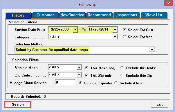

Sorry we missed this earlier. Do you want a list or to print the actual labels? You can do either one; if you want a date range that can be applied by building a query in Followup tabs.
- nickscarcare
- Posts: 898
Re: Customer report with name and adress
So how do I get the report with the name and address. It wouldn't have to go to labels, as long as I can get the list! With name and address.

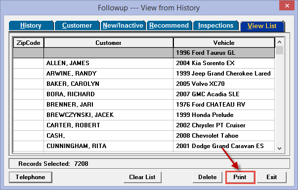

Manager 5.9 - Print customer list with addresses + date range:
Step 1: Reports - Followup tab (pick any we just need access to the tools) Step 2: History tab - set your Date Range and click Search to build the list Step 3: View List - click on Print Step 4: Printing Reports - select Print Labels (don't actually pick Customer List or you'll get work summaries too) then click on Print: Step 5: Print Preview - print to paper OR to labels if you have them
- nickscarcare
- Posts: 898
Thank you for the info. I was thinking the report would have pulled the list to the screen, but I see when you print to label, it shows everyone. This will work for what I need thank you again.

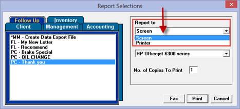

Your Reports printing selector determines screen preview or direct to printer:
- screen.png (36.68 KiB) Viewed 4783 times
- nickscarcare
- Posts: 898
Yep, I worded that wrong, I do have it set to print to screen, I didn't want to hit print and have it printing out 400 pages. I knew there should be a way, I just was nervous to hit that print button. Thanks again.
