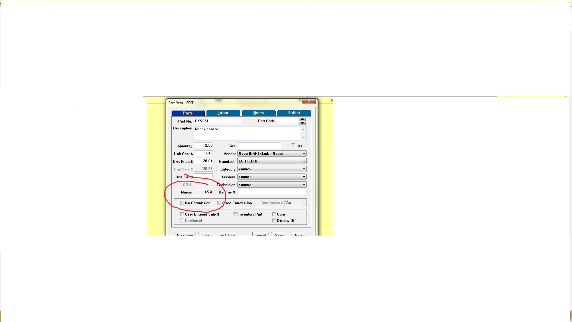

I personally want the user entered price option left alone. I have very few that are like that and do not want them changed unless I change them. Its easy enough to look at when I pull up the part #.
The % of markup is shown in the parts screen when you enter a number for easy viewing and allows you to adjust there as you would like.
- mitch.jpg (128.91 KiB) Viewed 3917 times

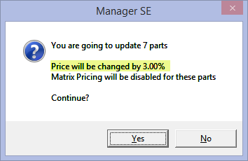

Another feature to consider is Inventory - Update; you may filter a range of parts (or select a single part) with Search then click on update and apply a % change to the sell price. Please note all parts selected will become User Entered Sale if they weren't already. Any value above 0 forces that setting.
