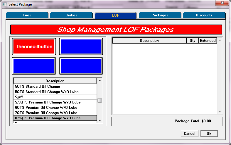

Under the current architecture, there are 5 oil changes listed for 4 different categories of LOF packages.
In my case, I want to be lazy & have 8 packages under one category for my synthetic oil changes. (5qt, 6qt, 7qt, 7.5qt, 8qt and then all the different weights - 0w20, 5w20, 5w30, 15w40, etc.)
To my way of thinking - if we can have 5 why not 8 or 10 or 20?? :)
I think we as shop managers should be able to add LOF category buttons ( for the weights) AND the # of packages we want under each category - IMHO>
I hope I described this to where everyone understands. (Probably not)

I think we get it. You mean something like this? (Ignoring the actual values)

Yes! THAT'S IT!!!
On the one category you screenshot here - I see you have 7 packages listed AND even added enough jobs to have a scroll bar for even more!!!
How'd you do it???? :shock:
I called product support and they said to post it out here under enhancements because they didn't have a ready solution.
I WANT, I WANT, I WANT!!!!

Posts: 1114
Re: More LOF packages & Categories
Sorry, just a mockup designed to show a rough outline of what you described. :oops:
The real thing would take some code changes in the manager application to allow you to add/remove more packages. I just wanted to make sure it was clear for Product Management.
