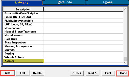

Here are the steps I'd use to set it up:
1. Setup - Standard Descriptions -> Category = add a new category and call it Lookers, Yelpers or whatever you want and save it.
2. Setup - Standard Descriptions -> Notes = create stored notes text IF you want to mail something and save it; if only looking for a calling list you could skip this step Here's the steps to use when they walk out the door:

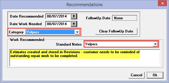

1. Go to Vehicle tab - click Add for Recommendations window
2. in Recommendations window -enter category created above (Yelpers, Lookers or whatever)
3. Do one of these below and click Done:
>>> a) Type 'call' in the Work Recommended area and OK to save it
>>> b) Click drop-list for Standard Notes and select the Notes entry created above (if you made one) Once a week (or whatever you decide) start the Followup process

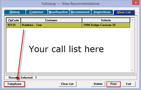

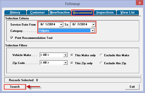

1. Go to Reports -> Followup tab -> double-click any report listed to get to the Followup tabs
2. Select the Recommend tab and get your date range and Yelpers category selected -> click Search to build list
3. Use the Telephone button to call each customer or print the list
4. When they agree to an appointment, consider deleting the Recommendation from the Vehicle screen.
