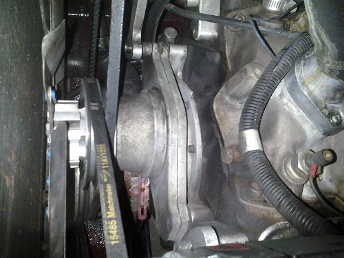

I have a customer here who bought a 1948 Mercury Street rod. The problem is the water pump is out. The water pump says lil John on it, which is referring to John Buttera who was a custom auto builder. He has since passed. I am wondering if anyone has seen his work, and if anyone knows if there are parts out there available. Before you say Ebay or the like it has been already checked. If I have to change the water pump to something else, I am going to have to change the timing cover, alternator brackets, air conditioning brackets. I have also been in contact with Chris Coddington, which is Boyd Coddington's son, who now runs the Coddington business. Boyd and John were good friends, he is checking on some stuff for me also. Just trying to see if anyone else has any ideas for parts.

This is a custom made housing and everything. Yes I was finally able to get it apart, and we have measured everything. The only way I have found the parts is to buy a water pump, disassemble the new one and then rebuild the old one.

So far measurements come up to a 6 cylinder gm water pump. I will keep you posted on what happens.

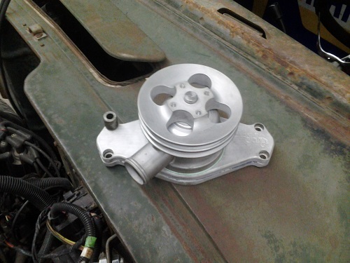

Here is the partially assembled new custom water pump. Now to see if it holds. 2 different water pumps to make one!

I have not had much hope in Cardone lately. A guy at the parts store and a local machinist were the 2 biggest help in this one. Even the impellers had to be shaved a bit in diameter to get them to fit properly.

A totally off the wall point here. Was the impeller balanced? I know it sounds wild but it may vibrate enough to cause sealing issues.

Here is the finished project. Car runs out good down the road. :D Yes it was all balanced and cleaned and put together nicely.
