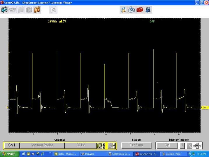

'scuse me for butting in, but I found this ordeal rather interesting to follow. The bottom line appears to be a lifter pumping up, but I'm still kind of curious about the scope trace that was posted earlier in the thread. That trace looked to me like it had a floating ground. Did you happen to capture a trace after the repair ?

ok let me see if I can do this .....
close enough I guess. This is what I would have expected to see as a scope trace on ths vehicle. Schematic shows this as a distributor engine so this is how a normal parade trace would look. Notice the fifth cylinder trace. Low firing voltage,ragged burn time, no distinct cut off, no coil ring. Firing order 18436572 this would be cylinder #6. Keep in mind that at 600 RPM, this trace repeats five times a second. At 3000 Rpm, 25 times per second. sometimes you gotta look through several traces to find an intermittent misfire. The image that you uploaded showed either a bad ground reference on the scope *OR* a bad ground in the ignition. Needless to say, the image you uploaded was not a viable reference. Thats why I was curious to see the "after" shot. If in the course of replacing the lifters you inadvertently fixed a bad ground in the ignition, you still wind up with problem fixed, but was it really the lifters ???

I can say with absolute confidence that there was no ground issue before or after lifter replacement. I dont see how a bad ground could only affect one cylinder in a distributor ignition. Not saying you are wrong, just dont see how.

The screenshot you posted is much different than mine. I would be more concerned with number 6 than 5.
