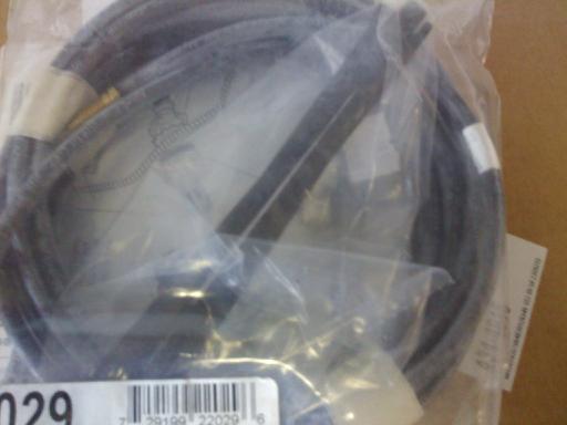

any name on the bags? airlift or firestone? or any pn's on the bags? i have replacement line kits avail different lengths and fittings depending on the bags
- airlift airline kit.jpg (18.74 KiB) Viewed 8325 times
