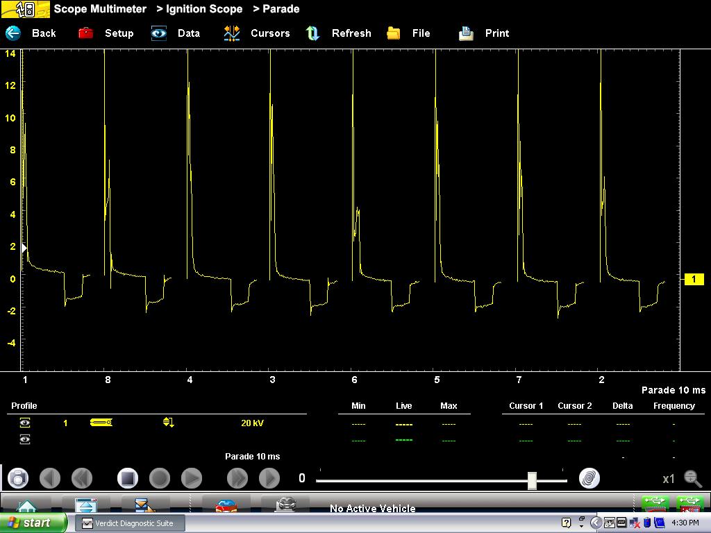

heres a secondary pattern during the misfire
98 chev 454 secondary.JPG (82.44 KiB) Viewed 10924 times

Found it on the scope. Number 6 and 8 had a difference in the secondary pattern during the misfire. It was hard to see in the screenshot I posted. I changed the scale to 15kv and it showed up nice. I'm not good enough with secondary patterns to pick out a problem. I have to look for variations between cylinders. I changed the 02 sensors and then I could see by studying the 02 patterns that the right bank was going rich. I couldnt pick it up with the old sensors. I guess they were too slow. Thats when I went back to looking at the secondary.

If you look at the scope pattern I posted you can see the problem cylinders as 8, 6, and 2. Of course its easy to see after the fact. :D
