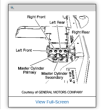

1GKFK66U73J313325 I am trying to find a diagram of the abs module that shows where the brake lines go to. All I can find is ones with only 5 ports at the module, and the Yukon has 6 ports, one line for each rear brake. It is near impossible to try to trace these things without dropping the fuel tank.

Spoke with the experts here and they gave me this info:
There is a TSB that has a year range from 1999 thru 2007 for this very thing - in 1Search, type in Brake Line, click on TSB Button, Anti-Lock Brakes - TSB Number 13-05-22-001D

I don't think you read the entire bulletin. Keep scrolling and you'll see the diagram that contains the 6 port system.nickscarcare wrote:Lazy Turtle, again that is for a 5 port system, I need 6. I can't imagine it is that much of an oddball, but it must be.
Re: 2003 GMC Yukon - Brake Line Identification
https://static.nhtsa.gov/odi/tsbs/2014/ ... 1-7817.pdf
Page 16 !!!!!!!!!!!!!!!!!!!!!!!!!!!!!!!!!!!!!

Ha I just went back and looked again, and I only get 8 pages of that TSB. I went in through a different source and yes it pulls all of it. Great technology when it don't load all the pages.
- nickscarcare
- Posts: 898
I was just trying to figure out how to get the picture resized, to load it on here. That is what I came up with after trial and error of blowing air through one line with the ends cut off. I figured there had to be a diagram somewhere.
