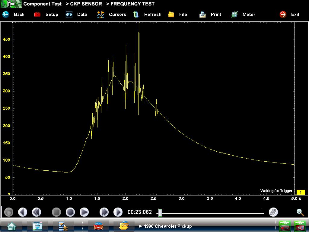

Now it throws a P1336 CKP variation not learned. I scoped the crank sensor and the signature looks OK. Ran a frequency test and get a bad glitch during the miss. Could the glitch be from the miss, or is it the cause of the problem? I swapped sensors from another engine (I know that really doesnt mean anything) with no change. I took a quick look at the tone wheel while the sensor was out. Didnt see anything major.

maybe this will work
- 20110425-1642-1.jpg (75.66 KiB) Viewed 13095 times

As I understand the ckp and cmp sensors, the crankshaft sensor simply tells the PCM that the crankshaft is rotating and where #1 is. The camshaft is used for fine tuning spark and injector firing. The glitch you see in that scope is from the miss. I am thinking that the ckp sensor will not create a miss, although I suppose anything is possible.

You are running a frequency test. Any engine speed fluctuation will show here. Better to do a signature test and look at the actual waveform. You can get a misfire when the cam/crank is not learned.

OK, double checked the dist gear (looks new). Found the "new" tps was shorted causing the ref volts to be low. Fixed that, but no change. Cant get that ckp glitch to show up again, so I guess that was a freak thing. Still wont crank variation learn. Gotta be related to the miss.
