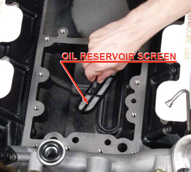

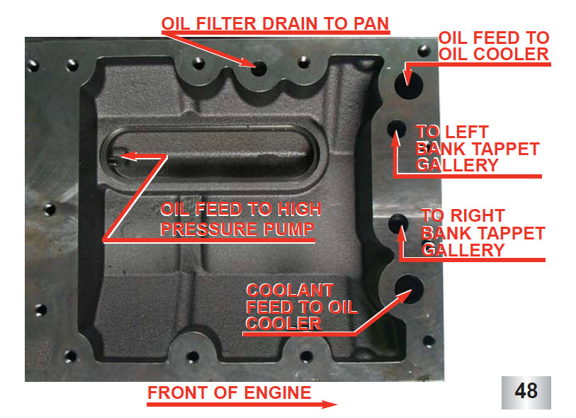

Have you had the oil cooler off? There is a screen under there that will come apart and let stuff get into the pump and cause it to lock up. Will look for my pics of the set up in the morning. I also have the Ford coffee table book on the ford 6.0 in PDF format. I would be willing to send it to ya if you need or want it. It has very good descriptions and pics of the entire engine assembly and all its sub systems.
- liljoe
- Posts: 1638
Re: 2003 Ford F250 - 6.0L HPOP Issues?
Here ya go.....

Let me show these to my tech, I kept sticking my head in there while he was working, I know we replaced these already, and I was adamant about getting the entire system cleaned out. ( which I am now starting to think is impossible without disassembling the entire engine..

Every time ive done an oil pump or heads the screen is gone missing. Ive never had one that had the screen in tact.

NPASC_mike wrote:Ford Dealer installed the first pump, We did the second under Warranty for Ford ESP ( which is the biggest joke of a warranty company I have dealt with yet) NOW my tech is telling me he doesn't remember seeing this screen...I guess I know what I am doing this weekend, Joe I sent you a private message. Sounds to me like my guy missed a vital step after we discussed being as thorough on this job as we could possibly be.
The screen is under the oil cooler cover at the front of the engine, not under the HPOP cover at the rear. With both cover removed and the pump out, I like to use carb cleaner and air pressure to clean the resivoir and passages out REAL good before reassembly. You will find around 1.5-2 qts od oil under the cover, so be ready for a bit of a mess....

I see some good pics of it now, Mitchell does not have that much about it . Him and I discussed this reservoir, which kind of ticks me off that it was not removed. Now that I am hearing what he's telling me, I'm not surprised it is back, which bugs me even more.
Some of you might laugh at this, I called my Ford parts dealer and he says to me, " Every now and then we get a batch of bad pumps...."
Last question, Is the cooler serviceable, as far as cleaning it out? Is there any reason I should opt to replace it while it's out?

i've always cleaned them. basically just a reservoir. i've seen them without filters before. why, i have no idea. just like in the cam timers in gm's, once i find metal in the screen it becomes a yearly thing. i've flat out told customers with these grenades (6.0) that once there is metal contamination the filter will probably plug up again within a year and need to be replaced. i have a customer that went ahead and purchased one without talking to me and has dumped about 8k into the engine and attachments. hpop, injectors, ( two on the drivers side head shut down and i strongly suggested replacing all and it was declined) 6 mos later the others needed replacement. we all know how much fun the drivers side on a e series is.
