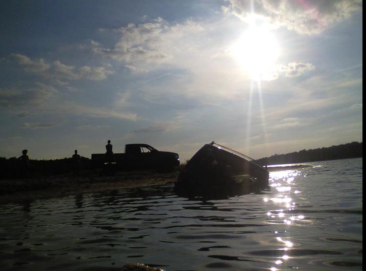

look for signs this jeep was prev used as a submarine or a duck boat. many of the kids around here have amphibious jeeps. we look for water lines (marks) under hood and dash. mud under carpet and mats. once it is confirmed to have been swamped all bets are off. let the insurance adjuster total it out. see my customers 2000 Jeep Cherokee. I have to admit the sunset is beautiful.
