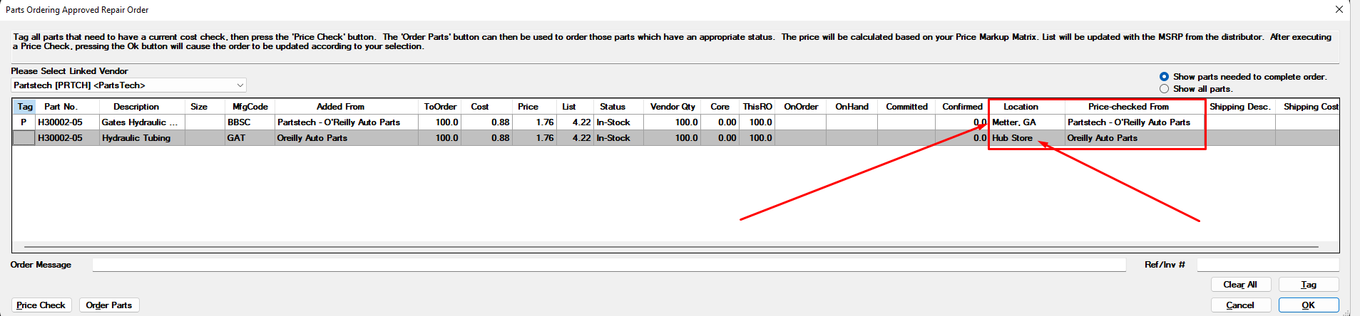

Just a couple of notes about what i have seen with PartsTech and areas i would be glad to see improved.
I have already reached out to Kenny and Alex at PartsTech about it, but will share here as well.
1. Parts looked up thru Oreilly FirstCall shows correct stock locations when performing a price check. Parts looked up thru PartsTech show local store location instead of actual stock location. (this can be deceiving when planning part ETAs)

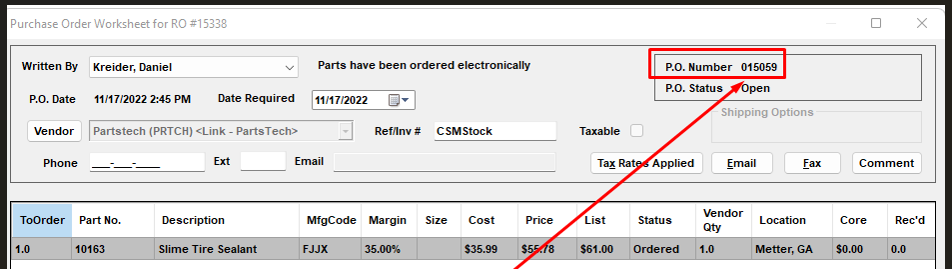

2. PO numbers do not transfer from ManagerSE to the vendor thru PartsTech. PartsTech appears to add thier own ambiguous PO#. See clippings below with Oreilly as an example:
This is likely the most time consuming issue; when receiving parts, the PO# is very important to quickly find the PO to receive the parts to.

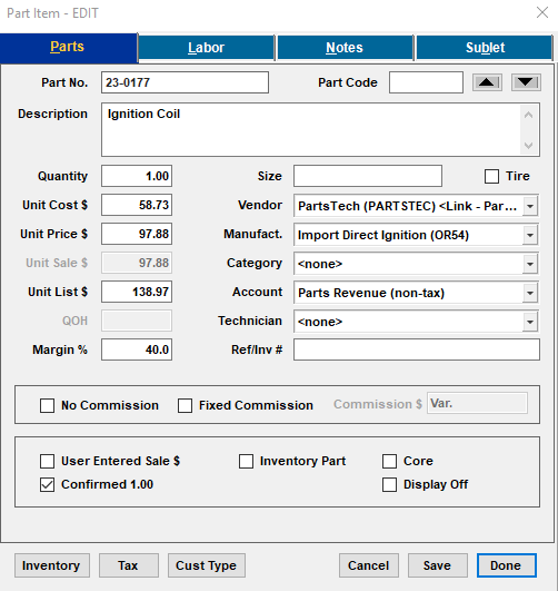

4. Previously stored inventory items do not transfer to the RO as inventory items when transferred thru PartsTech catalog. These same items transfer properly and show on the order as inventory items when added thru the FirstCall catalog.
Possible reason? - Line codes are different when migrated: taking a wix oil filter for example: PartsTech shows line code of BDCS and FirstCall shows WIX
I am beginning to believe that i may need to place all of my stock orders thru the FirstCall catalog for any items that i want to transfer as a stock item (important for maintaining stock quantities)

Nice work. I've reported most of the same things so far. The PartsTech PO number is actually their confirmation number. It's listed in the Comments section under Internal notes. The first day I beta tested this I noticed line codes were different for the same part. There's still work to do to polish this, but it's a great start.
