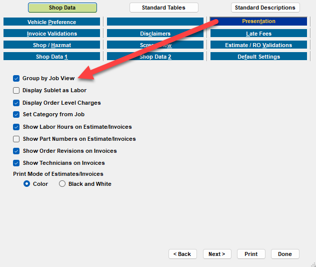

We are pleased to announce the Manager SE 9.1 Job View release! Demo of main features (2:45) link is below and more to come. Distribution for existing users is slated to begin on Nov 12th, 2024. I'm at AAPEX so it will be tonight before I can answer questions.
https://youtu.be/W2EjXi-rcxo
EDIT: Where to turn the Job View function on:
Presentation tab.png (30.96 KiB) Viewed 57489 times

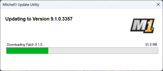

Manager SE 9.1 is available again from Help > Check for Updates menu right now. It is NOT available from m1files.com as yet.
SE 91 New Update.png (16.95 KiB) Viewed 58312 times

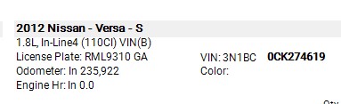

I am missing VIN digits on our printed invoices. The last 8 are there, and the first 5. Missing the 4 digits in the middle. Any one else having this issue?
Daniel Kreider
Posts: 50
Re: Manager SE 9.1 Job View release
Post by Daniel Kreider »
Yes, same symptoms here.
Vin Issue.jpg (13.71 KiB) Viewed 43670 times

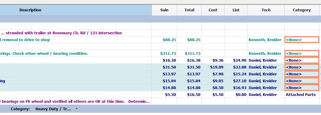

When attempting to apply category to a job thru the job specific category selector, the job line categories do not change to that category.
I have seen how the job category changes to the canned job category when added to the job if that option is selected in the setup window.
Am i understanding the intended behavior well enough to assume that this is a possible bug ?
I think i remember this function working this way right after installation but it no longer works the same way ...
Category Clip.jpg (102.41 KiB) Viewed 43670 times

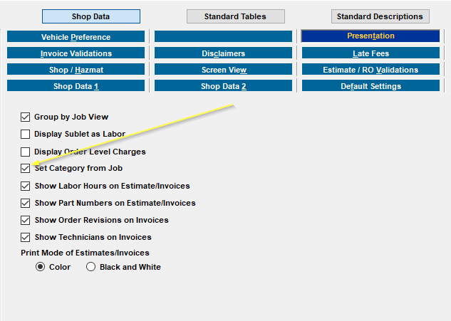

Daniel - please check to see if this got toggled off:
We're working to address this. Keep an eye on this thread next week - support will likely post when a fix is available.
