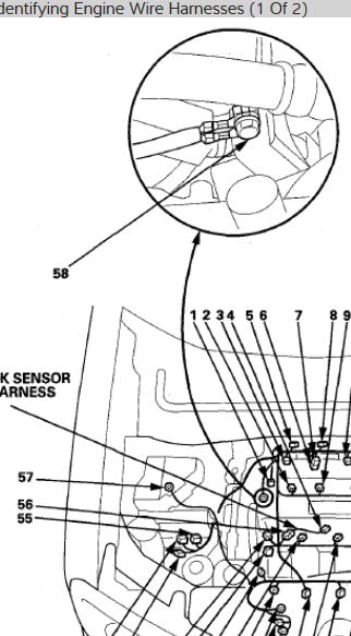

If he removed it, your tech may have forgotten to reinstall G101. This ground runs the transmission pressure solenoid and the pcm. That would explain the high pressure codes and possibly the p-code. The 83-11 is just a notification that there is a pcm code. Here's a picture of where it's located. Looks like it may be around or under the ps pump. Make sure it's tight and secure. #58 in the pic.

Thanks for the input Ric but this ground is on, clean, and tight.
