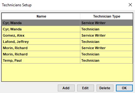

Re: Ghost Technicians?
Marking a technician as inactive has one function: to hide them from being selected in the scheduler. The concept of deleting a technician was discussed thoroughly and concluded with re-naming the technician with xx[technicianname]. This allows historical records to maintain their accuracy. As for the Service Writer showing up on labor lines, I suspect that there may be 2 records of that individual in the Technician Setup (Configuration Technician Setup) - one listed as a Service Writer, another listed as a Technician. You might want to call for support for assistance especially if you have an example to show us.
- Posts: 5999
Like this?LazyTurtle wrote: I suspect that there may be 2 records of that individual in the Technician Setup (Configuration Technician Setup) - one listed as a Service Writer, another listed as a Technician. .
Bingo!
