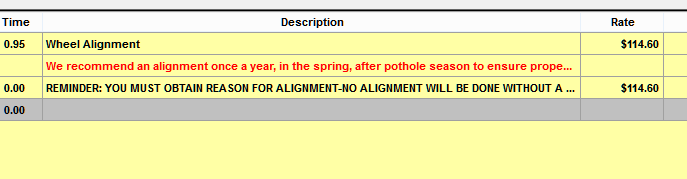

Not sure if this is a technical issue or an enhancement request, as I'm not 100% sure how this was designed to work in the first place.... But we can't get the notes field to print on our estimates when they're a Revision even when "Print on Order" is checked. The revision has to be sold before the notes field will show up on the hard copy, and that's kind of a hassle. It's possible I'm missing something though.

A main function of Revisions is to price out future jobs, correct? Why on earth would we not be able to include a Note line on a hard copy to present the customer with? Seems silly to limit that functionality.
EDIT: I realize this "issue" may not be intentional, but maybe it's just a limitation of the code? Sorry if it came out wrong. We include notes such as special warranty info about a specific job, future services we include with tire packages, etc. This would otherwise have to be written in a labor or sublet line so that it prints out. Some of these notes are part of a canned job. It would seem logical that this Note thing would function just as the live business part does.

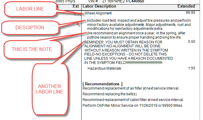

Let's agree on terms; the 'future work' (not approved yet) is stored on the Revision side. If I add a note to that, it can print with the Revision (uses the Estimate template) contents. That is what I would hand the customer to review. Since that is possible, why would we want to confuse that with Order screen (containing approved work under way)?

Please observe that notes print indented like labor descriptions, so they are easy to miss. Add a period in the first line and they will stand out better. JD was going to modify this template to allow for better visibility.

I had noticed in the past - if you are printing revisions when you have an invoice,repair order, or estimate on the main screen, the notes print. If you go to the revisions and print with out an invoice or estimate open the notes do not print. I just double checked to verify & that is still the way I see it working. It would be nice to have the notes print, as that is where we put the description of what work is to be performed. I.E. if you are only replacing one ball joint - left upper, or left lower etc.

This holds true for many aspects of the program. You need a valid order for most things to work properly. Make sure there is NOT simply 'NEW' in the order number field.
If you are digging up and old revision from a new order, copy it to the order screen and print from there, or enter something on the order screen to validate it.
