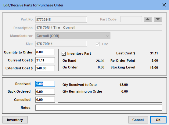

First, let's confirm we're looking at the same window.
PO edit.png (23.21 KiB) Viewed 5278 times
Please note that blue line around the OK button (above) is *not* the focus marquee; look closely at the other OK button (below) that does have the marquee added just inside the blue outline.
PO OK.png (527 Bytes) Viewed 5278 times

Yes that is the screen and what I am talking about. If the OK box in the PO window does not have the focus, why does pressing enter button close the box
Re: Purchase Order Cost Update
tanyah wrote:
Mon Sep 13, 2021 2:31 pm
Because none of the fields in the window respond to the ENTER key; without the marquee border around OK, it is essentially the same as Cancel. The expected usage is to use Tab key to get to field you want to make change in (cost, received, back ordered, etc.) and then tab to OK where it has focus to THEN press Enter to be same as OK (accepting changes).
