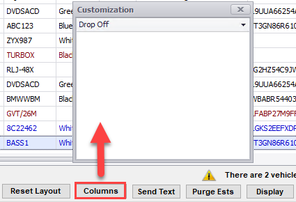

FYI - another method to remove columns is to click on the Columns button at the bottom of WIP.
It opens a box and you can drag unused columns into the box. Drag it back out if you ever want to restore a column.
Yes well, I tried that and it failed miserably to my frustration.
Now, after I removed the columns I do not want or need and restarted the management system, the one column is always there even though I "hide" it. If this is the best that can be done, well, we'll simply deal with it.
This was a big change with several conditions attached and we'll keep at it to get as close as we can.
I'm told this method is subject to the same rules as the Hide Column menu option. Which column was it? Could be mandatory to always be displayed.
