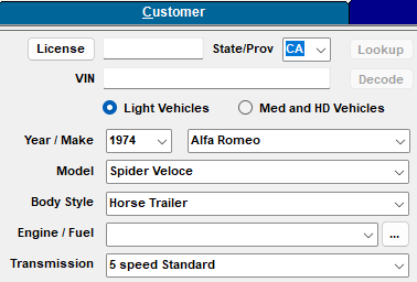

One suggestion is to pick an oddball YMM to be code for horse trailers.
First Call parts lookup (entering part #) and transfer was successful using this example:
