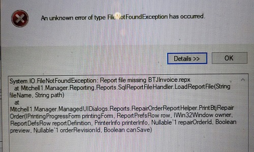

Getting error message when trying to print invoice. Only on my main pc. Can print work orders though..
Inv_Error
Inv_Error

We have been seeing this come up from time to time. There is a pretty simple fix for it by correcting the shortcut. You can follow the steps here https://kb.mitchell1.com/articles/id-1525/

Thanks. I did just apply the fix and it works now.
