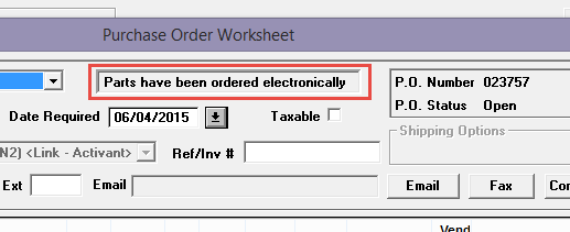

By manual PO do you mean a non-electronic vendor? If so, there is no mechanism to trigger the 'ordered' step, so no highlighting will occur.

I had a conversation with someone about this a while back. I was thinking there could be a button on non-electronic vendor PO's that could trigger the 'order' event manually. Then upon receipt parts could change to the other color. Would certainly help with manual PO's. Or don't make the PO unless you are ordering.

Perhaps there could be a window similar to this that appears when the manual order button is pressed that states, 'Parts have been ordered Manually'.
This way users can enjoy the benefit of highlighting even if they have no electronic vendors.
