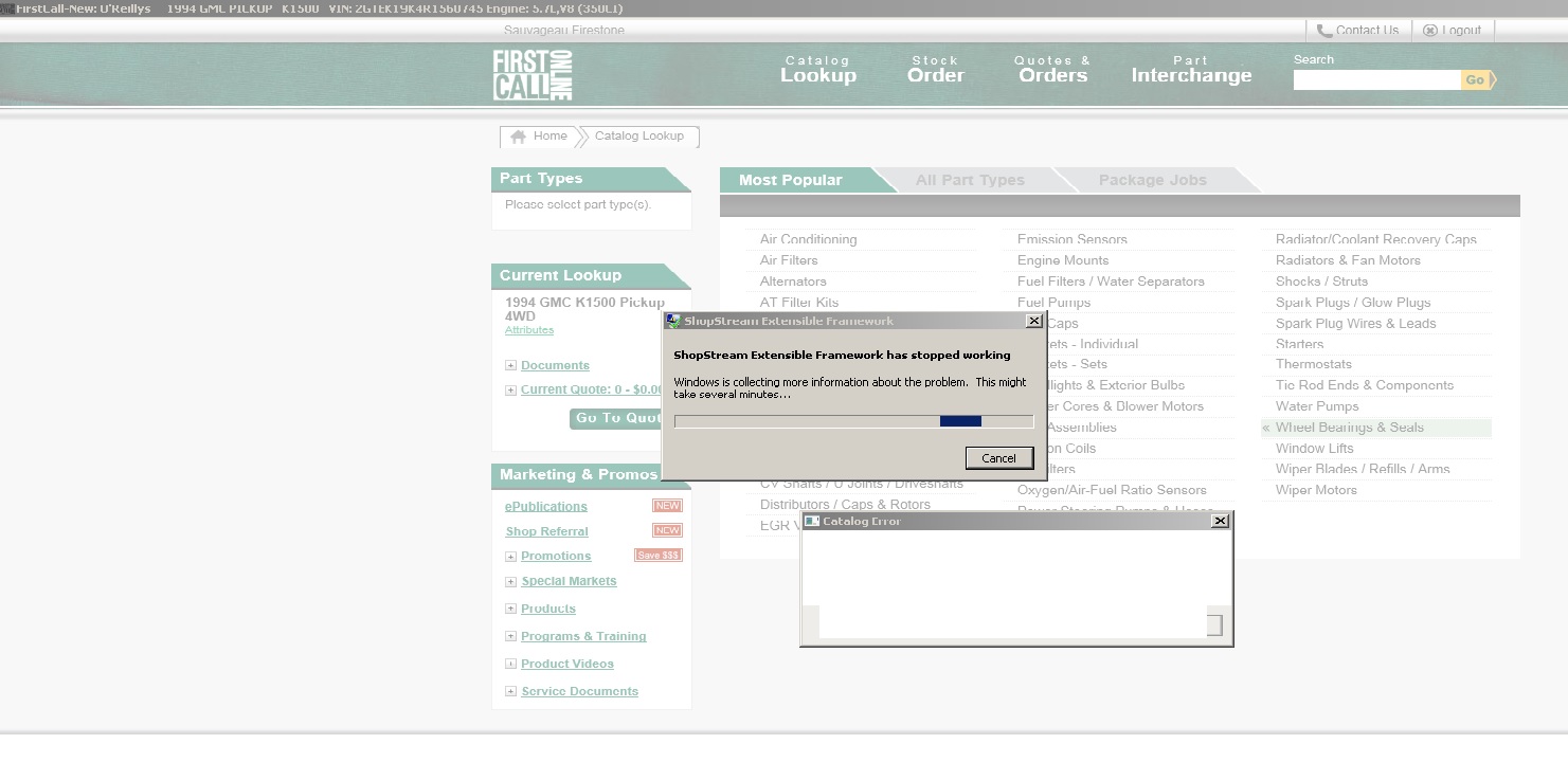

This is what happens to me, I'm not sure if it's only when I open FirstCall or just in generalSilky7 wrote:Thanks for the information. We've associated this error typically to the using the spell check component. We plan on replacing the core of that piece in the near future.
- 7.07 Crash.jpg (158.86 KiB) Viewed 12536 times
Re: SHOPSTREAM EXTENSIBLE FRAMEWORK HAS STOPPED WORKING
That is a different issue. See this thread for more information. http://www.managerforum.net/viewtopic.php?f=208&t=11785
