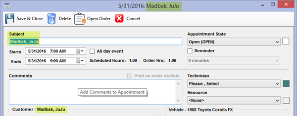

What version are you using? I'm not seeing that with 7.0.7; I can randomly create a new Estimate, convert it to R.O. and then click Options - Appointment and the Appointment Editor window opens with their name filled. Please advise of version # being used and the steps involved.

That's all well and good; this is with an existing customer record? So far I can't replicate your results. Here's mine for reference:
1. F6 New - enter partial customer name for existing customer record
2. Select their vehicle
3. Move to the order screen
4. Add a Symptom or Canned Job
5. Convert Estimate to R.O. [starting at R.O. no difference]
6. Options - Appointment opens Appt. Editor with customer name (as shown above)
EDIT: I made a brief video of the workflow: http://www.screencast.com/t/oms7mdEDlDvz

If you watched the video clip (link in my last post) and cannot duplicate those results, please contact tech support to look into the cause.priorityauto1 wrote:Basically any repair order I open, unless it is done through the scheduler, will not populate the subject line with the customer name when you try to add it to the schedule through the appointment tab.
