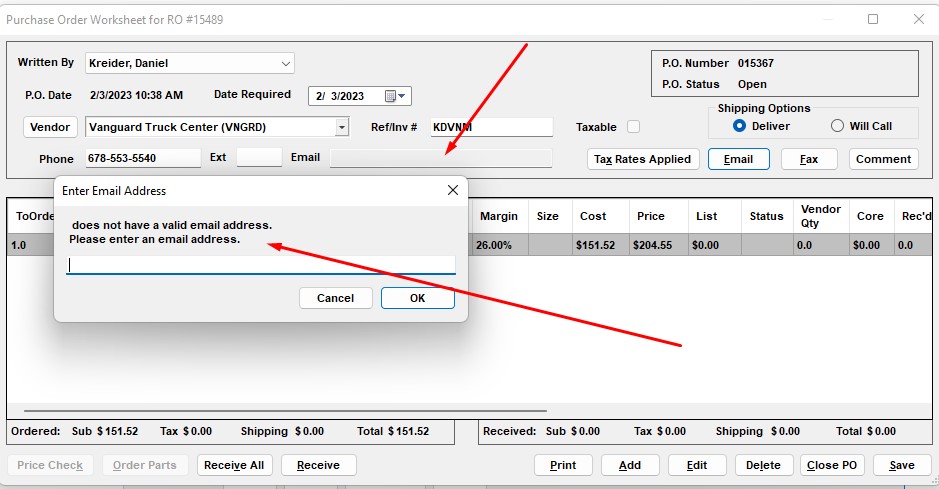

Another issue for the Pros to repair....
POs do not show the email field and when attempting to email a PO, a message pops up stating that this vendor does not have a valid email address when i know for sure that it does.
This function used to work to email a PO , but it no longer works in 8.5.1.378

megoff
Posts: 185
Location: San Diego, CA
Re: Update 8.5.02
Post by megoff »
Daniel Kreider wrote:
Tue Feb 07, 2023 12:01 pm
Thanks for this, we'll get this to our dev team

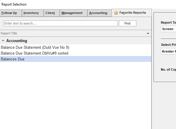

Another issue. Favorite reports list is forgotten.
This screen used to be full of my favorite reports, and now there are only 3 left.
I do remember using my user account yesterday on a workstation that rarely gets used and finding that the favorite reports list was empty, so i added these 3 reports, only to realize this morning that those are the only 3 showing on my main / master workstation and all of the other reports are no longer showing as favorite?
Can you tell me if this is a flaw or not ?

megoff
Posts: 185
Re: Update 8.5.02
Post by megoff »
Wed Feb 08, 2023 3:28 am
This is the first we've heard of anything changing with "Favorite Reports". We'll test this and see if we can replicate the issue. The modifications to reports from the 8.5.x release(s) are as follows:
  • Updated Scheduled Events reports to display Company Name with no order
  • Scheduled Events by Technician date formatting from dd/MM/yyyy to MM/dd/yyy to match all other date/time formatting
  • Program Security for individual reports in Management and Accounting
  • Purchase Orders (Closed Summary, Closed, Open) to display Supplier
  • Deleted Payments will show Refunded (negative) payments.
I'm not seeing any changes for the "Favorite Reports" settings in any of the changes. This User setting still does fall under our legacy settings where if 2 machines share the same user and for some reason they have different settings, the last station to close will "win" for the settings to be for the user.
For these settings we recommend the following:
  1. Closing ALL stations (including ones not using the user in question)
  2. Open the host or primary station
  3. Make all changes you'd like for any and all users
  4. Close primary station
  5. Re-launch all stations and all settings should be set to your liking.
