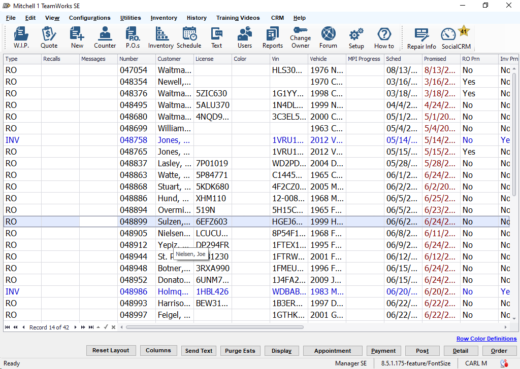

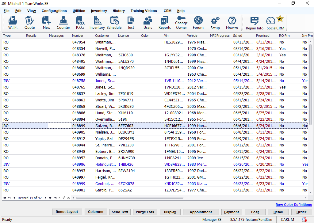

Posts: 1114
Re: Update 8.5.02
This will indeed be fixed in 8.5.1.
Apologies for the delay, but we also wanted to expand the customization of appearance based on early feedback to increase the font size, which came prior to discovery of the problem.
WIP in 10/11/12 point font:
This update should be available not too long after the holidays.
