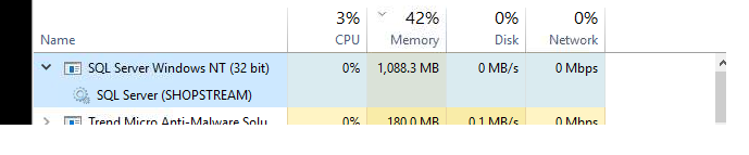

I just wanted to let you guys know that i have the same issue, the only way that i have to resolve the issue is to reboot the host machine. It seems that the longer the application is open more then 7 days in my situation the larger the sqlserver.exe process gets, as soon as this process reaches about 1 GB is where we are running into issues with the system slowing down, becoming almost unusable. My research online shows that there is a limitation with SQLexpress 2005, 2008, and 2012 that only allows for this process to only grow to 1GB and then basically will not let it grow any further.
I have attempted to replicate in a non-production environment but it seems the only real way to make this issue happen is if you are seriously using the system like the techs do every day other wise the process just responds normally.
So i guess my bottom line question is, what is causing the database to eat up all the available memory in the SQLexpress.exe process since its limited to 1GB per Microsoft website, and if we cannot figure that out, can the application have some kind of cleanup code run to drop all of the "junk" so we do not have to keep rebooting our systems.
