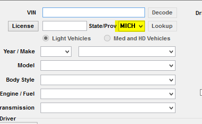

When we updated I found an issue, perhaps a setting some one (ME) missed?
I am trying to use the License plate decode. But my state defaults to "MICH" which is not making Mitchell1 happy. Most of the time I have to scroll down to "MI".
I looked, i really did, so can some one point me to the box I missed please.

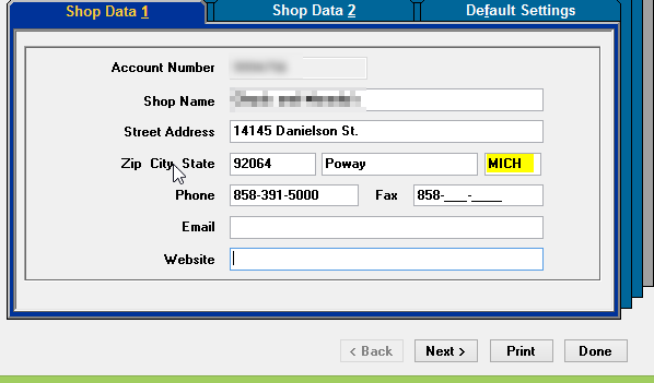

It's a simple change. Your default state selection is driven off your Shop Setup.
This is probably how you're set:
2017-04-05 09_23_04-Shop Data.png (14.7 KiB) Viewed 2364 times
And therefore you see this on the vehicle:
2017-04-05 09_24_52-Mitchell 1 TeamWorks SE.png (5.5 KiB) Viewed 2364 times
Close all your stations. On the host, make the change to just "MI" and then close it too. When re-opened, you should be all set for new vehicles.
Re: Default State Is Wrong-ish?
Awesome! It was set at "Mich", I changed it.
Thank you!
