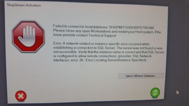

Since the update to 7.3.10 and the lovely Windows 10 update - we have been getting a database error message. Sometimes when we are trying to cut & paste we get a message that says the connection to the database has been lost. But if you click on continue you can move on as before.
- Error Message
- 20180518_0842012.jpg (44.03 KiB) Viewed 7615 times

I am also experiencing random database connection errors, sometimes we can start the program back up and we are on our way other times it requires a complete reboot.
Got a who new error the morning, I have never seen this error!
Is there any resolution or feedeback on this yet????
Error: in Explorer.EXE "The group or resource is not in the correct state to perform the required operation."

I was having problems with my computers on the same network not wanting to talk to each other after the Windows update, along with the problems with reaching the database.
I found that the Function Discovery Resource Publication in services.msc was now set at manual & stopped. Once I reset it to automatic and started it on all the computer I can access the other computers again & so far....have not had the database issue with Mitchell.
