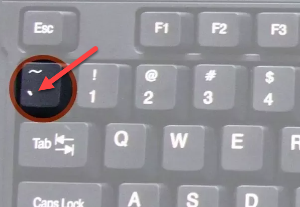

Historically, the apostrophe (') character has been reserved for programming and therefore pressing the ' key does nothing. We have recommended using a different key that IS a legal character to use as it is very similar:

I suppose a tic/grave accent could be used however a customer name rarely uses grave whereas customer names frequently have apostrophe's. You can change a customer name to add an apostrophe after it's created. It just opens things up to confusion when trying to find a customer in the system. Did they type a grave, apostrophe, or neither as they may not have been aware of the grave as a substitute. Seems to me that in this particular case it should be allowed when creating a new customer unless of course it creates some kind of sort issue later on with reports or elsewhere.
