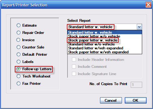

Thinking this was just answered in a different post recently; I believe in changover to SE, a report selection changed to not include vehicle option.
Go to Configurations, Reports/Printers, change selector to Followup Letters. See which template is selected, change to w/vehicle option.
This should do it.
This should do it.

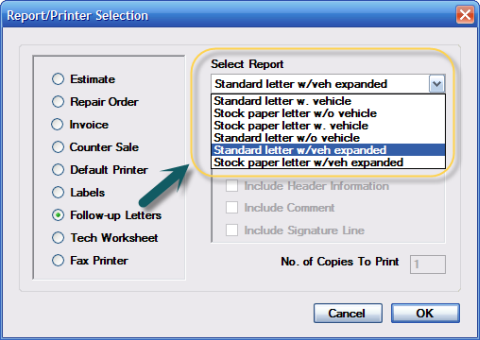

There is an issue in a couple of the templates, one of which you may have selected. I tested them all here.
Go to Configurations, Setup Reports/Printers section. Change selector to Followup, then select one of two templates I have indicated:
