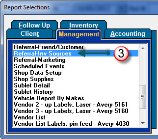

Somebody asked this before and I built it into my demo database. The Source field on the Order screen can be used to code invoices to sales people and track with reporting:
- source1.jpg (14.64 KiB) Viewed 4229 times
- source2.jpg (31.53 KiB) Viewed 4229 times
- source3.jpg (49.36 KiB) Viewed 4229 times

Thanks Tim
I think with a little figuring i can make that work.
