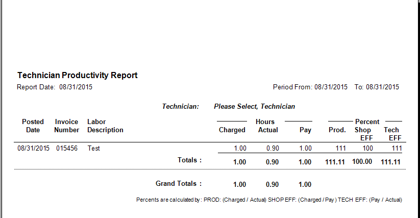

Under Business Report Summary I am trying to understand how that reports came up with Tech Efficiency %. If a tech has some comebacks on a repair where do yo document these so they are relected in the report?
thanks
Re: Tech Efficiency %
michaiel,

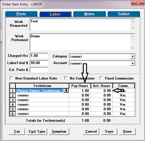

A technician's efficiency is calculated by the hours you specify on a labor line item. For example:
Will give the result in the report:
Comebacks are separated into their own report under the Management tab. They are marked by Using Symptoms, then checking the Comeback option.
I will add that if you want come-backs factored in, input the actual hours and leave the pay hours blank.

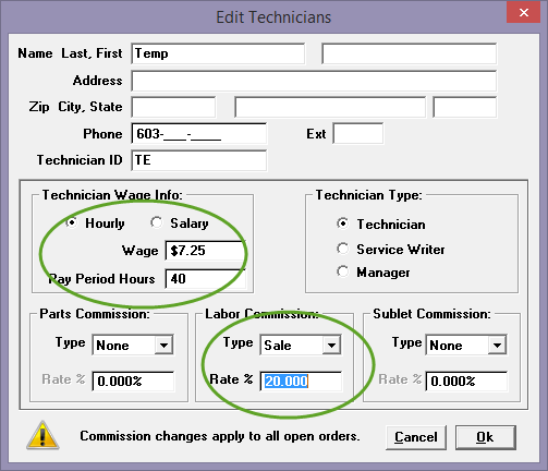

Is there a way to default the fixed commission amount for each tech instead of manually entering each time?
Possibly. How are your techs paid?
michaiel
Posts: 33
Joined: Thu Aug 13, 2015 5:17 am
Post by michaiel »
hourly and commission
7.25 / hour + 20% commission on the labor they turn
Then you would set the tech up like this......
tech setup for 7.25 per hour and 20% of billed labor

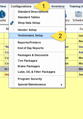

Go to Configurations>Technician Setup.

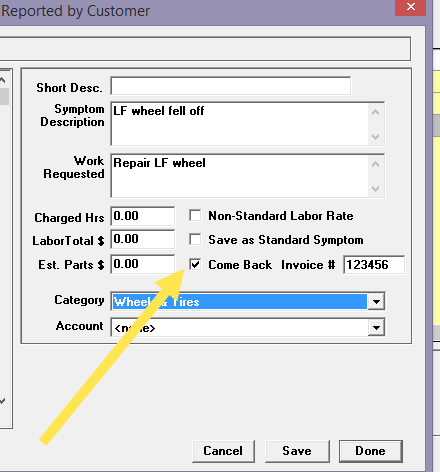

How or where do you enter "combacks" if a vehicle returns? I want to be able to track the techs combacks with the reports.....
Jeff @ Able Auto
Posts: 1705
Post by Jeff @ Able Auto »
Under symptoms. To the right is a box to check for come back and a slot for the prior invoice number.
To drive the Comeback Report, the Comeback box must be checked on the Symptoms screen along with a VALID previous visit invoice # for same customer & vehicle must be entered. This tags the second invoice to be in relationship to the previous visit invoice.

We have a nice system for taking the Come-back report a little further.
As stated earlier, you enter the come-back info at the Symptom screen....
Initiate come back

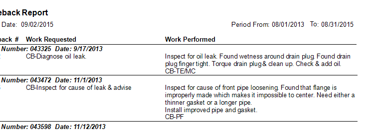

Initiate come back
To further indicate the type of comeback and a tech's responsibility, we code the labor so it shows up on the Comeback report. The Work Performed field shows for each labor marked as comeback. At the end of our description of work performed, we code the labor as technician error (TE) or part failure (PF) followed by the tech's initials. I would look something like TE:RM. This is meaningless to the customer as it's displayed on the Invoice. Below is a sample comeback report.
Sample Report
Sample Report
I hope that helps a little.
