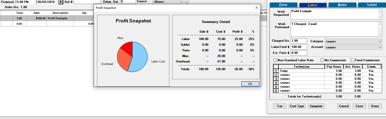

The system will calculate exactly as you suggest, provided you input the data. For this example, I used the $25 hourly rate as you suggested, but rounded the 3.1 to 3 even for simplicity. (Ignore the miscellaneous overhead)
And the reporting still shows the hits to productivity and efficiency the shop took:
Hopefully this helps?

Again thank you. But as your example shows the tech efficiency is at 100%. We always have the charge hours & tech pay equal so what we bill the customer is what the tech gets credited for. The efficiency percentage is also a number that we use for our techs annual review.
Which leads me back to the original question of having a true labor margin on the repair order. Since our techs are hourly the ticket can never show a true profit margin on labor with having the correct efficiency. If I am not understanding this correctly I can be contacted at 856-234-1868.
Thank you again for your time and consideration.

Please explain. If you are paying by the hour, you need to enter the figures as I described above. It's the only way to report true labor costs when paying by the hour. The report and columns work best for FLAT RATE pay. IGNORE tech efficiency column when paying by the hour. USE productivity column to measure your techs when paying by the hour.In our case the pay hours and the actual hours cannot be the same because that is the way we measure the true efficiency of our technicians
