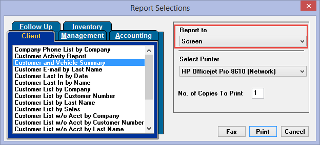

If I understand your question(s), it's as simple as hitting the Print button on the History screen. This will display a summary with parts/labor detail for all of the invoices for that customer/vehicle, if that's what you want to see. You can browse and skip pages too.
NOTE: Your system should be set to Print to Screen; this is where the setting is in case you need to change it:
