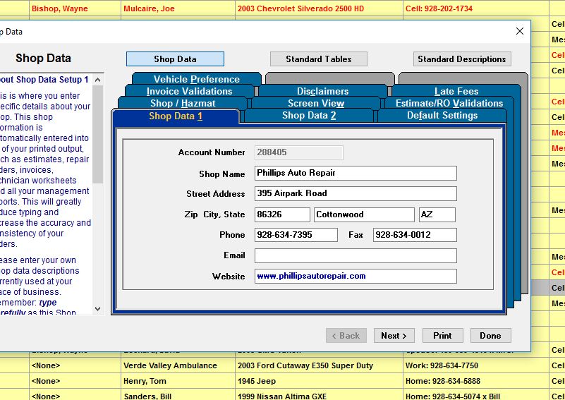

Is it possible to have our shop email and cell number included in the header on estimates & invoices?
Virginia
Virginia
Re: Shop email on invoices/estimates
You can play with the shop data 1 and 2 to get what you would like.

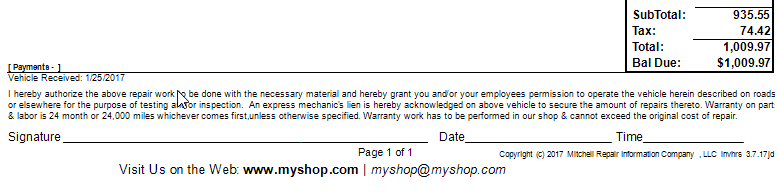

Thanks, but that doesn't necessarily mean it's printing. The email doesn't print. I've put both bits of info in the 'slogan' area to get them to appear in the header. It would be nice if the fax number didn't print if there is no data there.
Setup, shop data, shop data 2, Slogan.
We have www.chuckandmeredys.com entered and it shows up on all of the estimates, printed ROs and invoices
