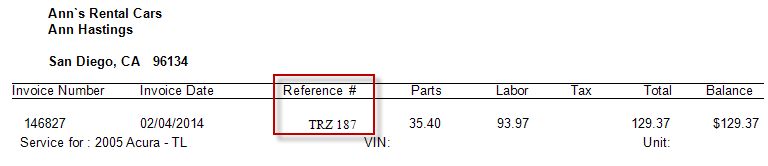

Okay, I was referring to the Balances Due report. I can submit an inquiry to product mgmt. for a potential change.
In the meantime, a simple trick is to enter (or copy) the License plate into the Ref # field; that way the plate appears along with the amount due:
- plate2.png (10.66 KiB) Viewed 2486 times
