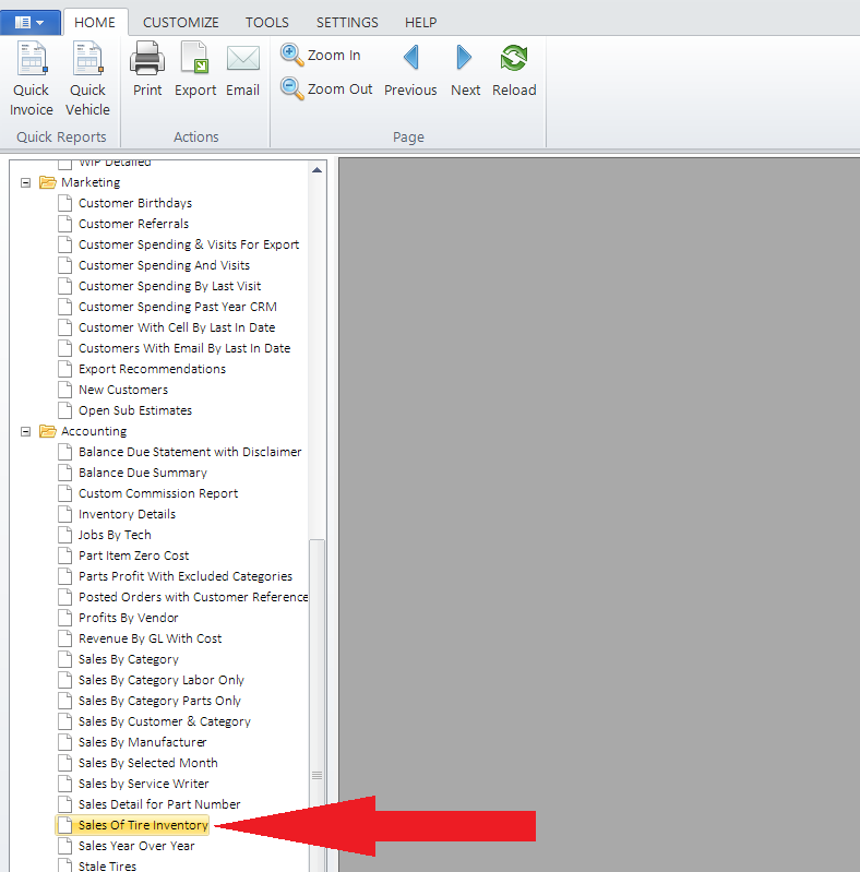

I'm hoping someone can make a suggestion for a report to use. What I'm trying to find is the cost and sales price of tires I have sold withinn a given time frame. the tire count would be nice to with labor dollars for mounting and balancing. I've tried several reports but am not getting exactly what I need. Maybe I'm missing something. Any suggestions would be apprecaited.

I don't think there is anything in Manager that will do this now. There may be a report like this in Report Pro from Bolt-On.

Hi Paul,
The report you're looking for is available through Report Pro. Please let me know if I can be of further assistance.

FYI. The report in Report Pro only shows inventoried items that have been sold. It does not report the outside purchase tires sold, which are most of our sales. (This is the same for all of the tire reports in ProPack). Most of our tire sales are non-stocking, in which case we run the Materials Used report in Manager and manually enter to a spreadsheet. It would ne nice to have a report showing cost/sales/profit of all tires sold - inventoried or non-stock.
