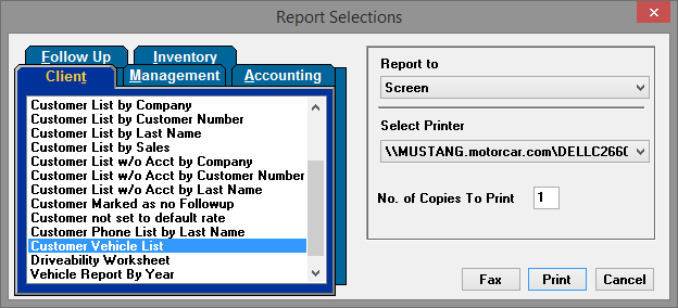

Customer list by company and put in customer number and it comes up with list of vehicles.
Re: Vehicle list report
That report is called Customer Vehicle List and is found under the Client tab of reports.
It will indeed print a simple listing of all the vehicles for a selected customer.

Sheriff Dept has 28 cars in the system, report prints 18. Guess I need to set the date farther back? or am I doing something wrong?
Yep, that did it. I sent start date to 01/01/1995 and i got them all. Thanks!
Yes, I forgot to mention there is a date range in there too. :oops:
