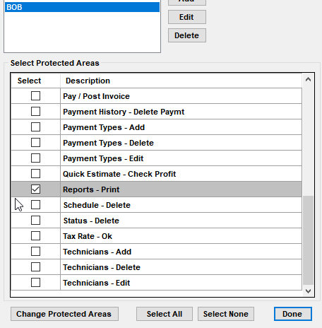

Hello,
The current program security can be a little tricky. What you'll want to do is to make sure the area is checked if you want the user to have access. If it's unchecked, that means the user's password won't get them into that area.
So you'd want your area to look like this for the SA that you want to allow printing:
2018-11-29 09_00_58-Window.png (11.18 KiB) Viewed 4696 times

Thanks for your reply, that is correct, Reports-Print is check marked for the service advisor in question. His password assigned to him will not allow him to access reports.
