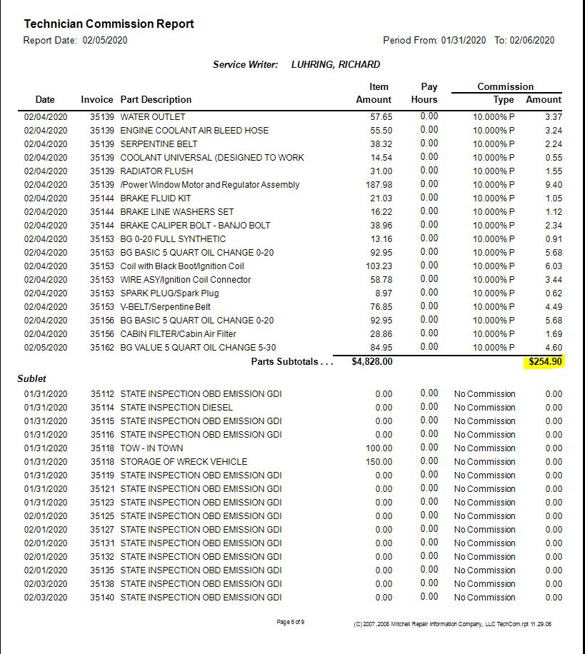

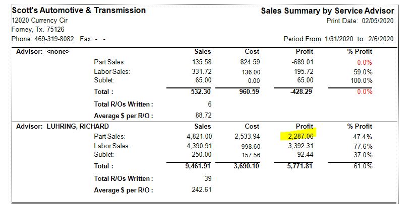

On the Tech Commission Report it shows you a break down of the commissions earned for each part for each person and totals it at the bottom, but when you run the Sales by Service Writer Report it shows you the total profit. At our shop they use the Sales by Service Writer Report and figure the 10% commission from the total profit total, which does not equal the total from the Tech Commission Report. Trying to figure out why there is a difference when they should be the same.
Capture 001.JPG (186.54 KiB) Viewed 6601 times
Capture 002.JPG (65.93 KiB) Viewed 6601 times
10% of $2,287.06 = 228.71 which is different from the $254.90 total on the Tech Commission Report
