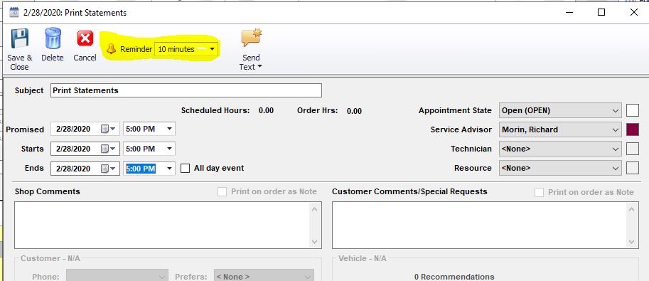

Best practice for today is to print your statements at the end of the month. You can have the program remind you by creating a shop event in the Scheduler and checking the reminder box. This will pop up on ALL workstations and remind you to print.
reminder for statement printing
