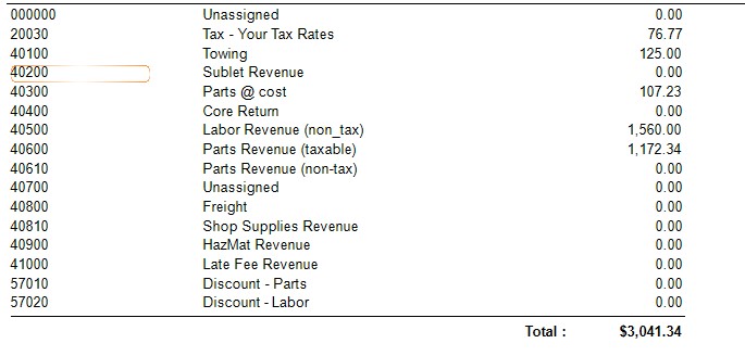

Are you wanting something like this??
If so I can TRY to tell you how i set ours up. This is for towing

yes, as long as i will be able to break it down at the end of the day and it wont go into the labor total.

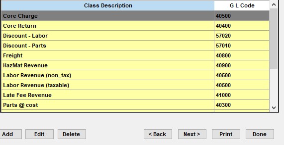

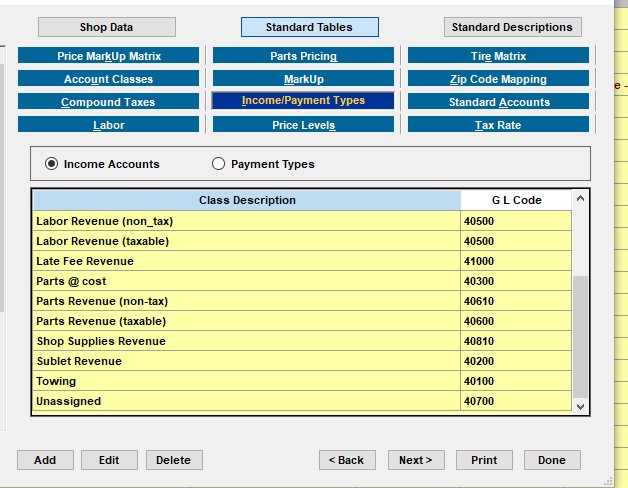

Re: Sublet
Be warned! I know NOTHING about how GL codes effect ANY export, IE - excel or any other accounting software!!!!
I went into
Set up
Standard tables
Then I used the "ADD" button and added "Towing" and made the GL code something not already used....appears I picked 40100
I also made one for "parts at cost" and used 40300
On the invoice it does show "sublet" but does NOT show if it is towing or any other type of "sublet". Just as my "parts at cost" still show as normal parts on the invoice, however, it does break it out in the report I use at the end of the day. (see screen shot above)
The report i use:
Reports
Accounting
Revenue by GL code.

I see when you double click on those codes there is a sub category for those is there any need to do anything there ?
