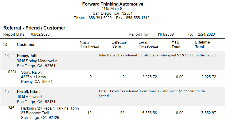

The report Management > Referral-Marketing will track invoices posted by customers with this set.

Referral - by user defined options or friend (existing customer) = ONE TIME - how the customer came to be added to your database (website, friend, etc.)

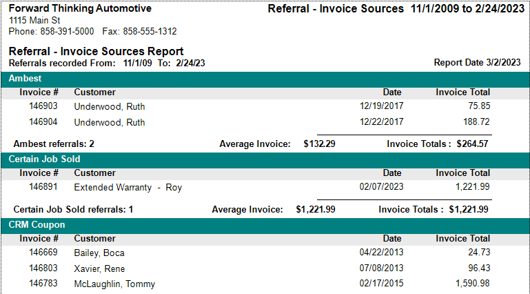

Source - by user defined options = why EACH TIME an invoice came to be written (website, radio ad, CRM coupon, etc.)
Under Reports > Marketing tab, select Referral Friend/Customer option. The report will include invoiced work that occurred during the selected date range. Remember, the Referral is a one time event; that may have happened back in 2016 but that should not prevent showing that relationship resulted in invoiced work in 2023. That's how it has to work. You will always have new customers, they may not include any referral data every time. Maybe you want to use Source to "see" where the work is coming from.
Under Reports > Marketing tab, select Referral Invoice Sources option. The report will include invoiced work segmented by the user defined options. The dollar amounts generated will indicate what's popular and what's not. What's Working? You want to determine which marketing efforts are effective whether they are new customers or not. What's making me some business?

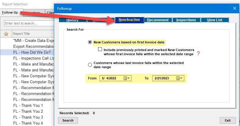

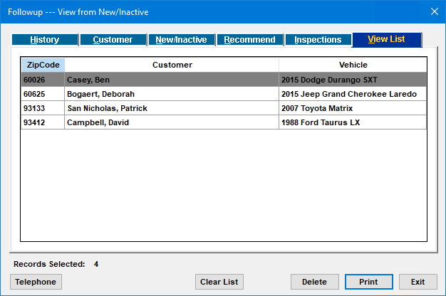

Under Reports > Followup tab, double-click any FL report listing to gain access to the Followup tabs. Select Customers based on first Invoice date and set a date range. Click Search to build a list of customers who had invoiced work during the date range.
