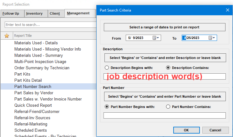

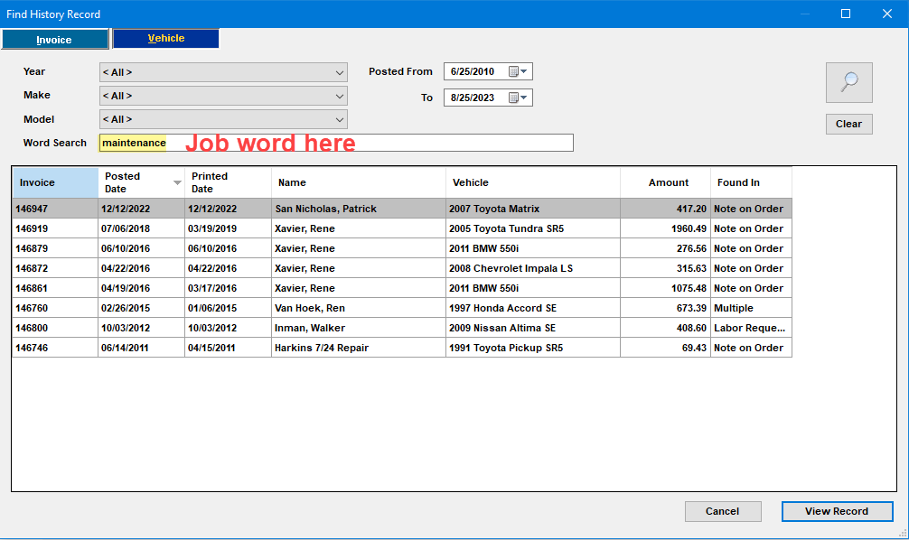

1. F4 Find History - VEHICLE tab: Leave the Year/Make/Model fields blank and enter a partial labor description into Wordsearch field and then count the results. This does return customer, vehicle, invoice #, posted date, printed date, invoice $ total. NOTE: View Record would be used to see invoice detail.
2. Management tab > Part # Search report: use a partial P/N and/or description to get a range of data returned (customer, vehicle, invoice #, date sold, etc.

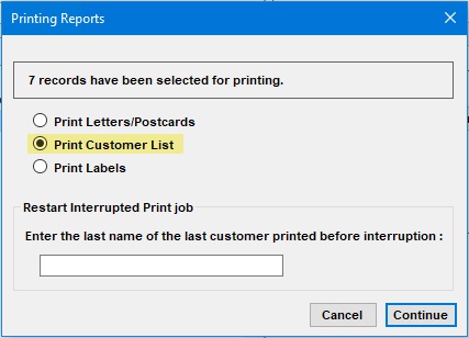

So say we have a brake special for a month, I would like to have a report that I could go into the brake category, and pull all the ones up for that timeframe. I would have thought there would be a report for this so that way someone could track how much work in different categories they were doing to see where the money comes in at.
Re: CATEGORY SEARCH
nickscarcare wrote:
Mon Aug 28, 2023 9:39 am

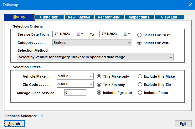

Thanks for providing a SPECIFIC example to wake me out of my rendered report thinking. Try this:
1. Reports > Followup tab
2. Double-click on any FL entry (we're not going to print the letter) to get to Followup screen
3. Set Service Date to match your brake special month
4. Set Category to Brakes
5. Set to Select for Veh. (Select for Cust will include their other vehicles if any)

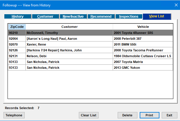

6. Click on Search to build your list; switches to View List tab

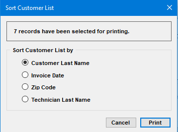

7. Click on Print; select Print Customer List option; click Continue
8. Select the Sort Customer List option you want (Last Name, INV Date, Tech Name, etc)

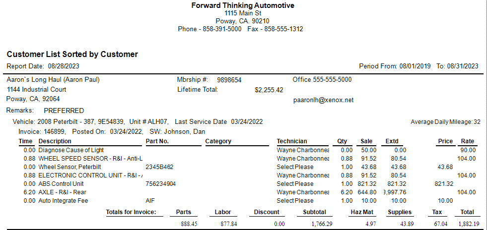

9. Your results (totaled for each customer) appear across several pages; view, print or save it as a PDF
f4 sort.png (7.07 KiB) Viewed 12675 times
