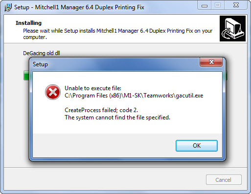

I just tried to run the file and I get an error 'Unable to execute file - gacutil.exe not found - error code 2'
Bruce
- M1 Error.jpg (67.5 KiB) Viewed 8807 times

I get the same error now... standby

Fixed today - fix at: http://www.m1faqs.com/fix/SE/6.4_DuplexPrintFix.exe
