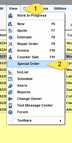

Thank you for your speedy reply. All of the scenarios that you presented will work perfectly for the ideas I have with regards to open labor claims against parts warranties. But at the risk of sounding completely stupid, or at the very least blind, I can not find the "view" button you are referring to to create a special order. I have an open repair order, I have highlighted the labor and parts lines I want to carry over to a special order, .....but then I'm stuck....

No worries. It's hidden in plain sight.

Scratch that last thread....dummy me was looking for a button!!!
I have transferred all my open labor claims and de-cluttered my WIP screen....very cool!!!
