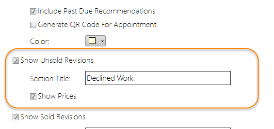

- Posts: 5999
Re: Declining lines without erasing-
You can turn off the declined work feature in the Propack invoice here.....
