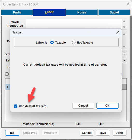

A control was added to make departures from default labor tax settings.
When you open the tax table for that labor item in the Canned Job you gain access to this:
Tax option labor.png (32.9 KiB) Viewed 22728 times

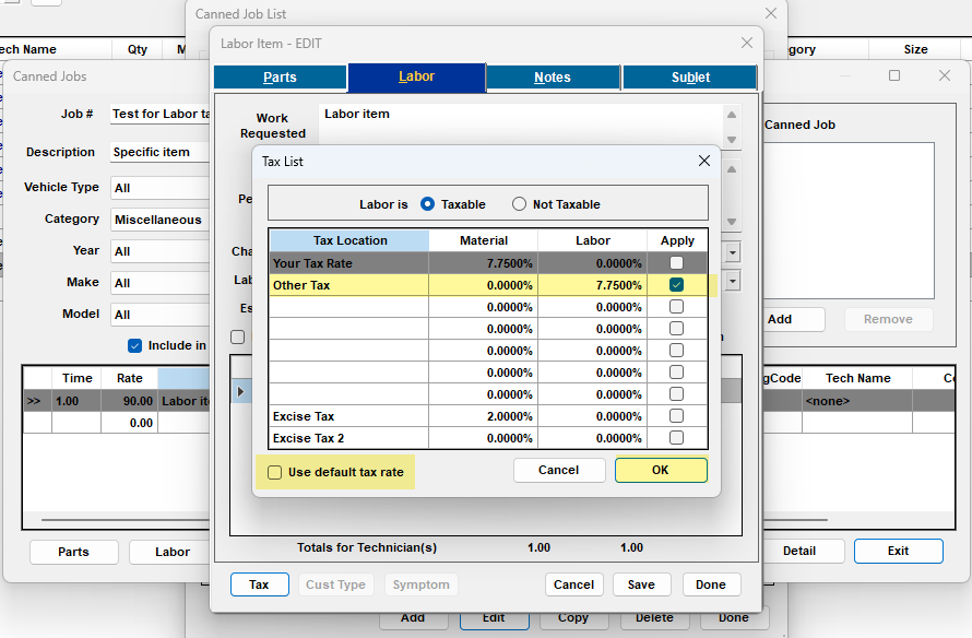

I think you missed a step where you needed to check the box in the canned job; it does work as follows:
1. The labor tax needed exists in your tax table (line #2 or similar)
2. The labor line in the canned job has the checkbox unchecked (exposing the tax table)
3. Check the box for the labor tax on line #2 (or similar) and click OK to save it.
4. Sell the canned job and observe the tax on the order has changed accordingly.
CJ labor tax.png (77.61 KiB) Viewed 22637 times

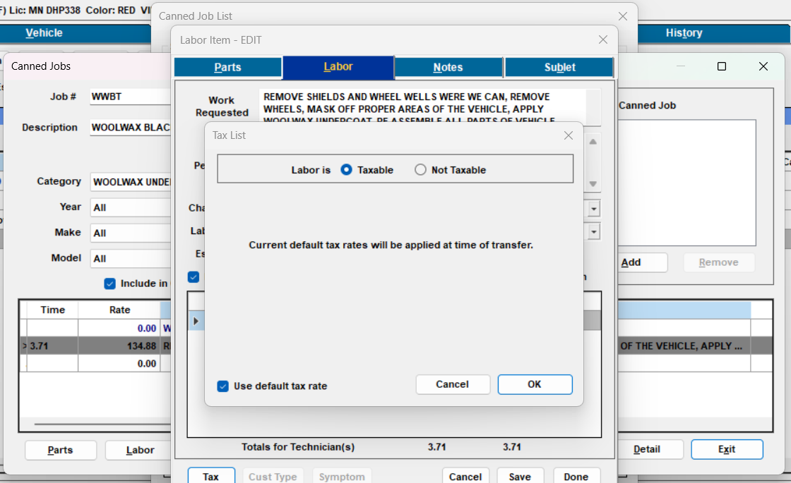

Screenshot 2023-12-14 162217.png (186.14 KiB) Viewed 22559 times
nickscarcare
Posts: 898
Re: Apply tax to, labor
Post by nickscarcare »
That is what I have

Okay.
1. UNCHECK the box for default tax rate.
2. Then select the tax on line #2. (we believe you have this in your database already)
3. Click OK to save this detail of your canned job.
nickscarcare
Posts: 898
Well I believe that worked, I thought that box would have had to be checked to have the tax applied. Hmm seems to work now thanks!!!!

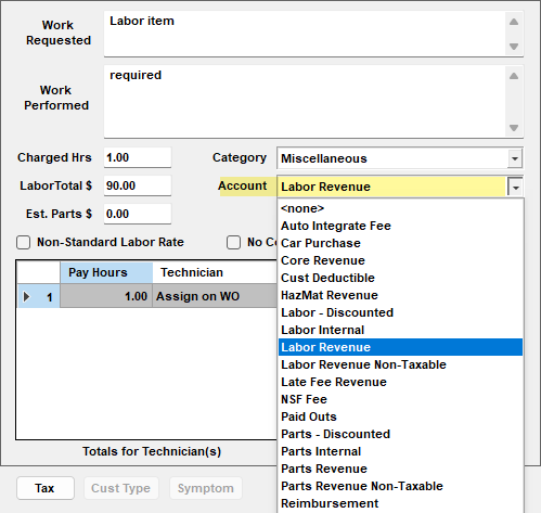

That reminds me; the account class (revenue bucket) for THIS item should be set to Labor (Taxable) as all your labor normally gets recorded under Labor Non-Taxable. The invoice was going to be correct, but certain reports might be off a bit.
Labor taxable.png (27.61 KiB) Viewed 22123 times
